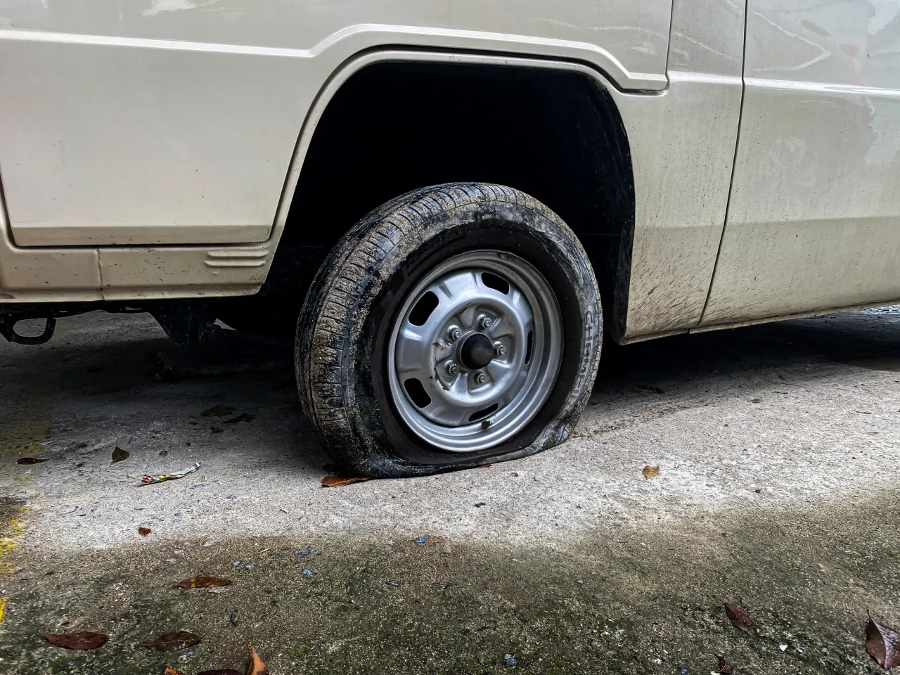

Step-by-Step Guide To Changing an RV Tire
Once you’ve confirmed it’s time for a tire swap and your tools and safety steps are in place, it’s time to roll up your sleeves. Changing an RV tire might sound intimidating, especially given the size and weight of the vehicle, but with the right approach, it’s entirely doable, even for first-timers. The key is staying calm, methodical, and patient.
Here’s a step-by-step breakdown to help you do it safely and correctly:
1. Secure the RV
  • Before starting, double-check that the RV is on stable, level ground.
  • Chock the wheels on the opposite side of the flat tire to prevent rolling.
  • Engage the parking brake and make sure the vehicle is fully stable.
2. Loosen the Lug Nuts
  • Use your lug wrench to loosen – but not fully remove – the nuts.
  • Work in a star or crisscross pattern to avoid warping the wheel.
  • Pro tip: It may take some serious elbow grease. If stuck and cannot be loosened safely using the appropriate tools, stop and seek professional assistance.
3. Jack Up the RV
  • Consult your owner’s manual to find the correct jack point near the tire.
  • Raise the RV slowly until the flat tire is just off the ground.
  • Never crawl under the RV while it’s on the jack alone.
Roadside professionals have specialized tools to handle complex or high-clearance RV tire changes. If your setup makes safe access difficult, call your provider instead.
4. Remove the Flat Tire
  • Now, completely remove the lug nuts and set them aside.
  • Pull off the flat tire and lay it flat under the RV as a safety precaution.
5. Mount the Spare Tire
  • Align the holes and slide the spare tire onto the bolts.
  • Tighten the lug nuts by hand in the same star pattern to seat the wheel evenly.
6. Lower the RV
  • Carefully lower the RV until the tire touches the ground.
  • Once it supports the vehicle’s weight, remove the jack.
7. Fully Tighten the Lug Nuts with a Torque Wrench
  • Use your torque wrench to finish tightening the lug nuts in a crisscross pattern.
  • Follow your RV manual’s torque specifications – usually between 100-150 lb-ft.
8. Double-Check Pressure and Clean Up
  • Use a tire pressure gauge to confirm the spare is properly inflated.
  • Store your tools, stow the flat tire, and remove any safety equipment or chocks once you’re fully done.
