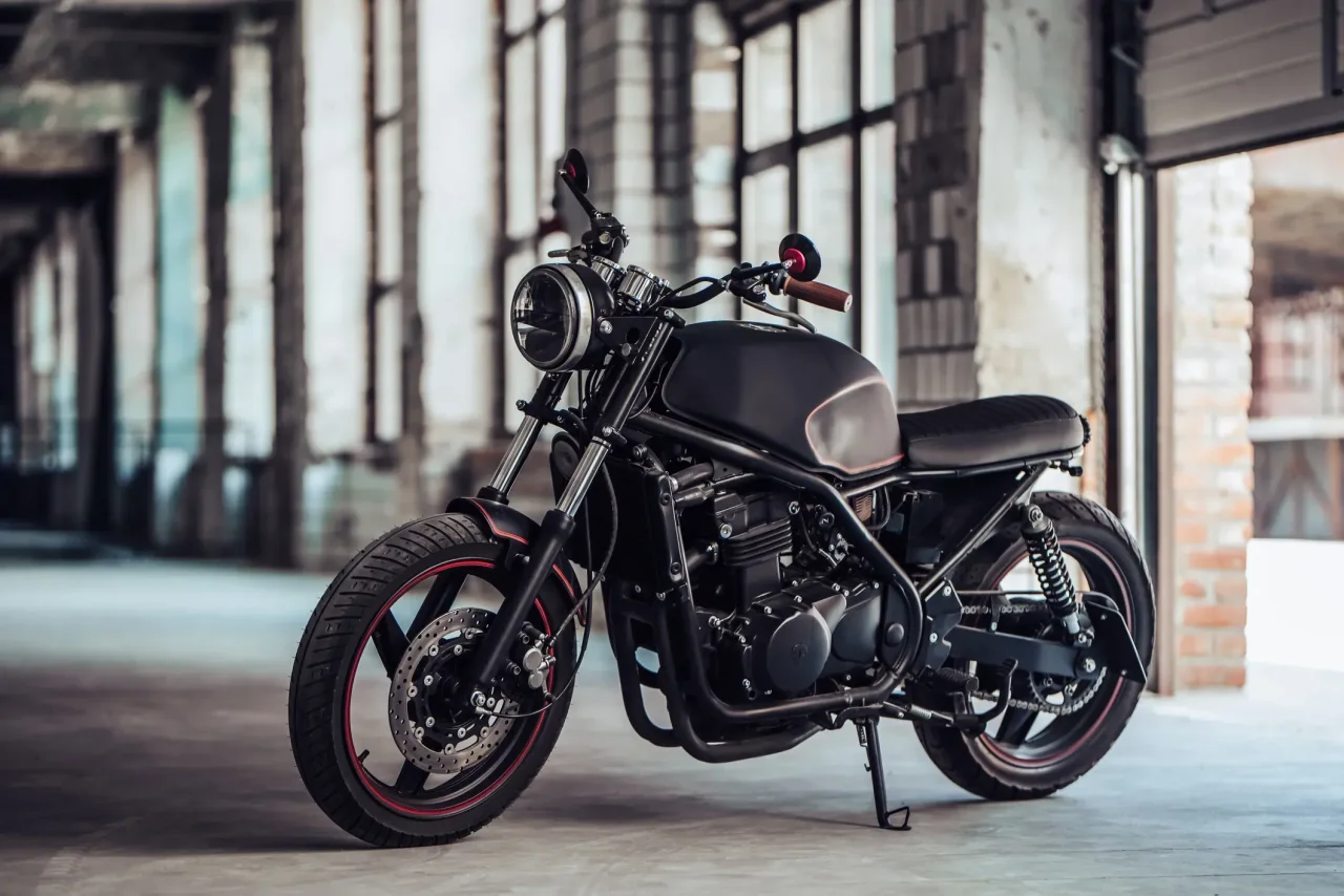

A black cruiser motorcycle in a garage full of windows.
