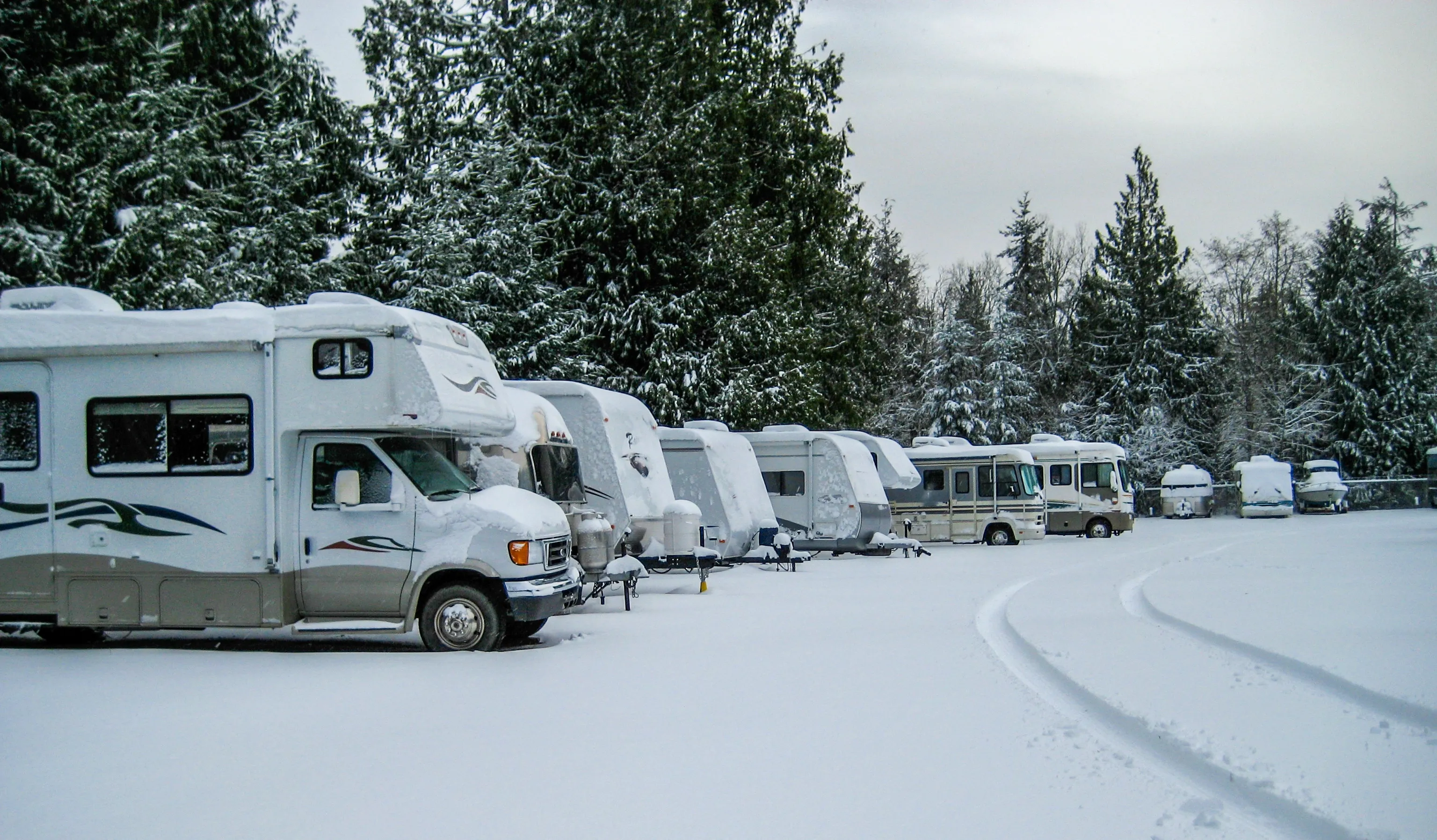

Class A motorhome parked in fresh snow with icicles along the roofline, surrounded by snow-covered evergreen trees.

Step 1: Choose your storage spot
  • Indoor, climate-controlled storage offers the most protection. Covered outdoor storage is a good middle ground.
  • If storing outdoors, park on level, well-drained ground away from trees.
