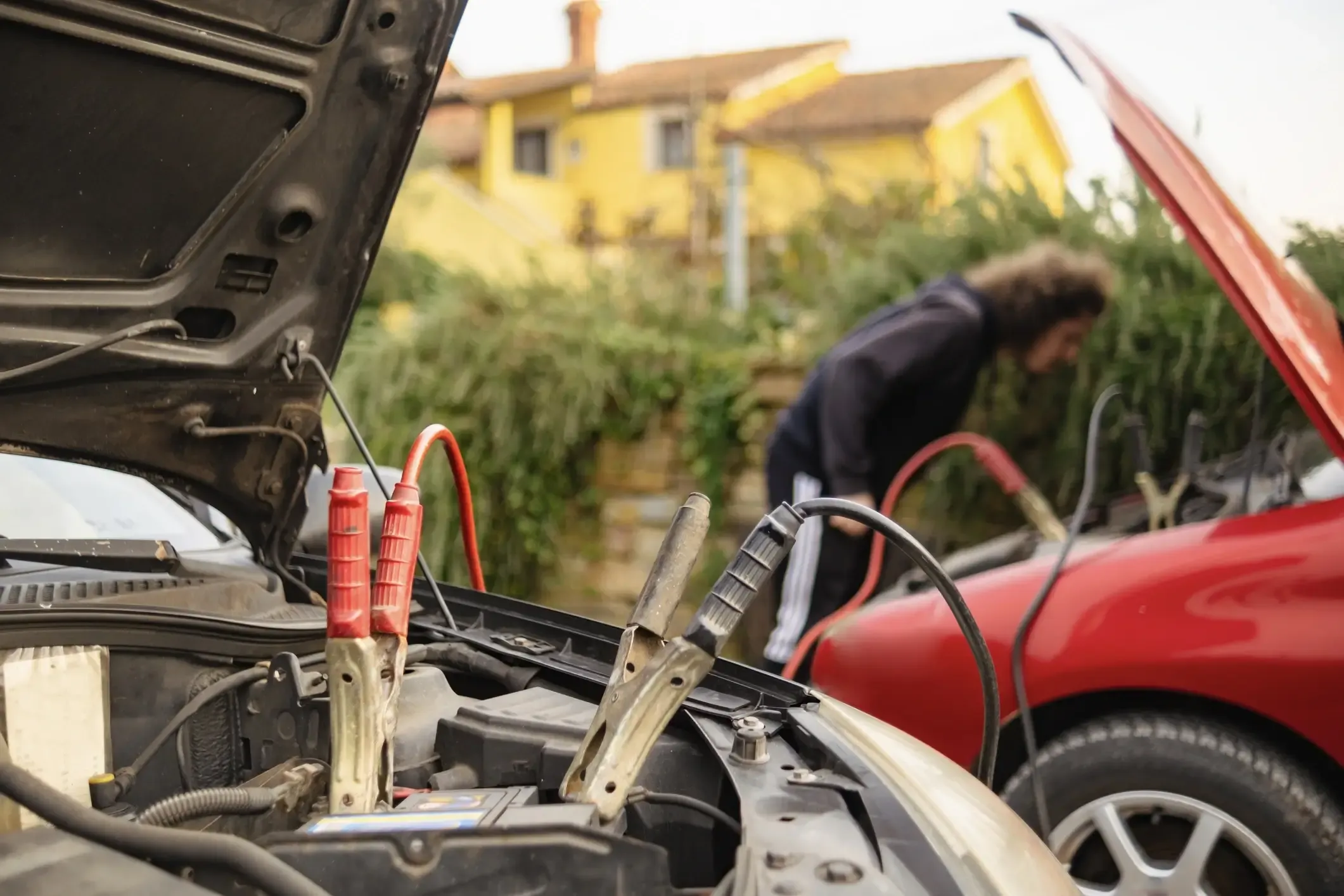

How To Jump Start a Car with Cables
Follow these steps carefully to jump start a car using a set of jumper cables and a donor vehicle. This is the proper way to create a safe booster cable connection.
Step 1: Park and Prepare
Position the working vehicle so the batteries are as close as possible without the cars touching. Turn off all lights and accessories in both vehicles, open the hood and identify the positive and negative terminals.
Step 2: RED to DEAD
Attach the red clamp to the positive (+) terminal of the dead battery. It is usually marked with a “+” sign or a red cover.
Step 3: RED to DONOR
Attach the other end of the red clamp to the positive (+) terminal of the working (donor) battery.
Step 4: BLACK to DONOR
Attach the black clamp to the negative (-) terminal of the donor battery. It is usually marked with a “-“ sign or a black cover.
Step 5: BLACK to GROUND
Crucial Step: Do not attach the final black clamp to the dead battery’s negative terminal. Instead, connect it to an unpainted metal surface on the engine block or frame of the dead car. This “grounds” the circuit and prevents dangerous sparks near the battery.
Step 6: Start Engines
Start the donor car and let the engine run for a few minutes. Then, turn the key and attempt to start the dead car. If you hear a clicking sound and it does not start, wait another minute before you try again.
Once the vehicle starts, let it run for at least 20 to 30 minutes so the alternator can recharge the battery. Turning the vehicle off too soon may cause the battery to die again and require another jump.
Step 7: Remove Cables Safely
Once the car starts, remove the cables in the exact reverse order they were attached:
  1. Black clamp from the grounded metal.
  2. Black clamp from the donor battery.
  3. Red clamp from the donor battery.
  4. Red clamp from the (formerly) dead battery.
Take care not to let the clamps touch each other or any metal surface during removal.
