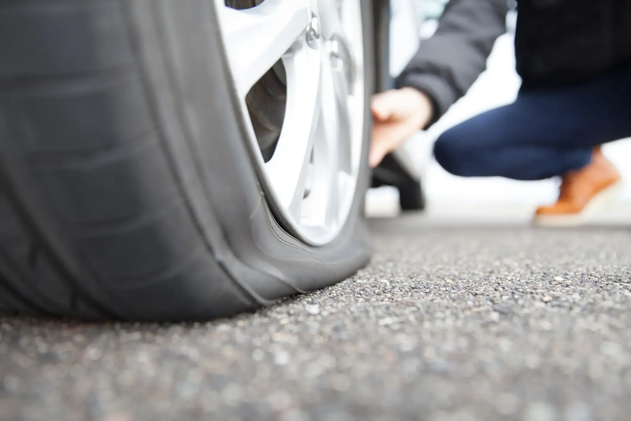

Close-up of a punctured tire on an alloy wheel with a person inspecting it on the roadside
